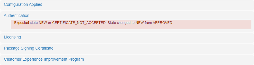

Logging in to Aria Orchestrator fails as well as configuration validation from control center fails with error:
Expected state NEW or CERTIFICATE_NOT_ACCEPTED. State changed to NEW from APPROVED
