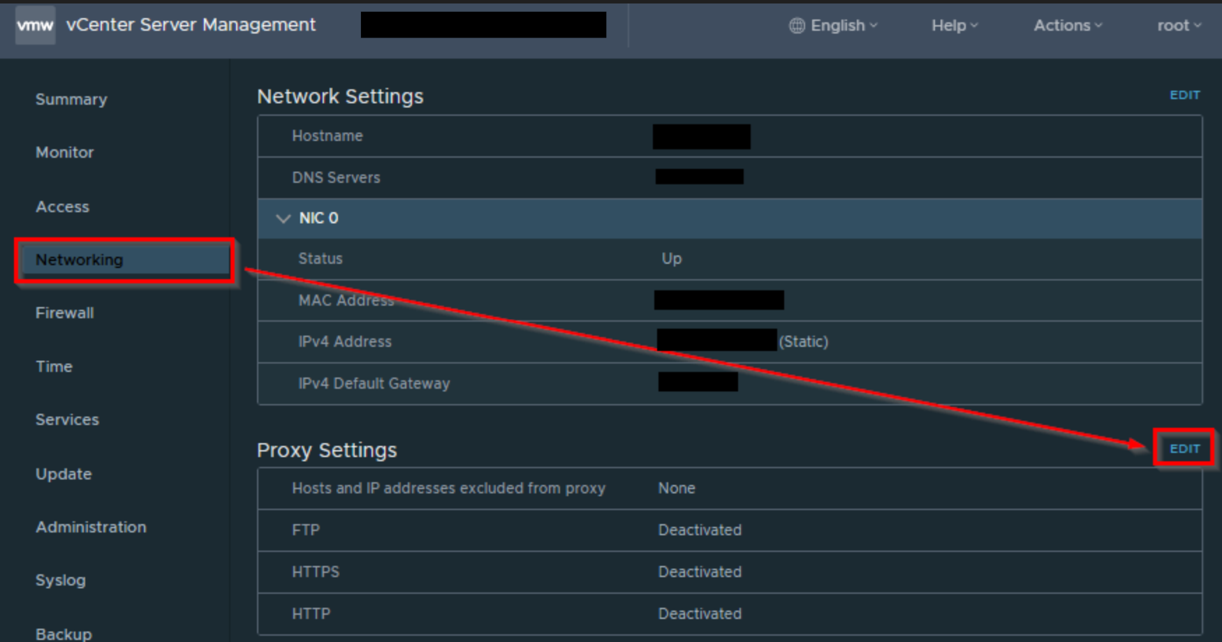

Option 1 - setting proxy URLs using the VAMI GUI:
  1. Open to the VAMI URL https://<vcenter_fqdn>:5480 in a web browser and log in using either the root account, or the default administrator (administrator@<sso-domain>)
  2. Open the Networking page and click on the [EDIT] button for the proxy settings:
