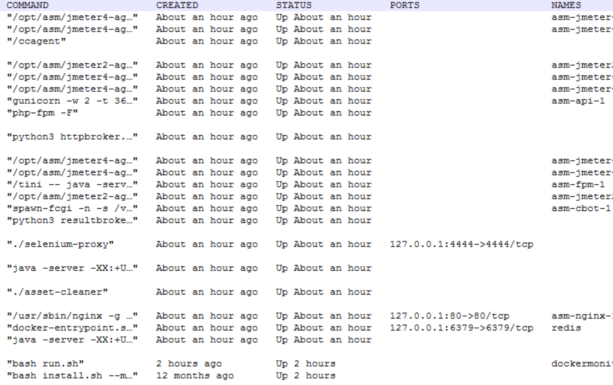

the below message is reported continuously in the dockerd log
dockerd[1990]: time="2024-06-15T22:51:05.164509439+02:00" level=info msg="failed to read ipv6 net.ipv6.conf.<bridge>
asm containers seems to be working as expected
