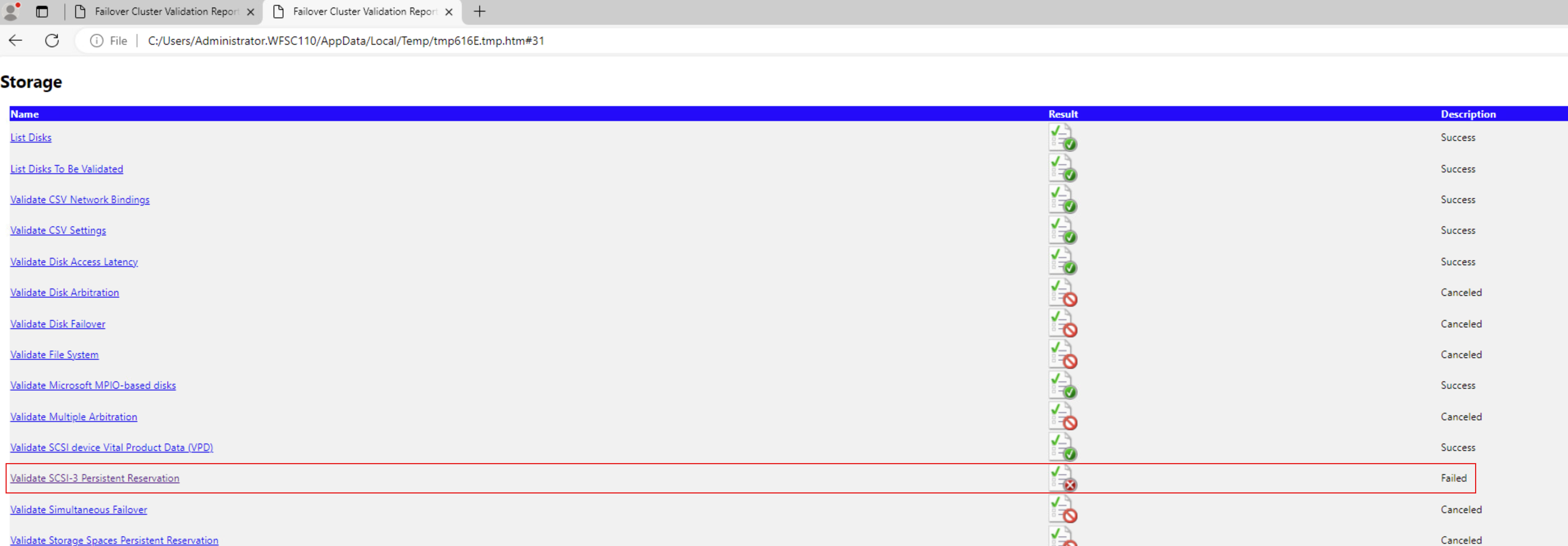

  • However with NVMe guest controllers as the frontend; having SCSI-backed vVoL disks are not supported, and this may result in failure  while running WSFC cluster validation for Storage Tests.
  • "Validate SCSI-3 Persistent Reservation" is the specific test that may fail:
Note: The  above issue is applicable only with WSFC clustering solution on vVOL with NVMe as guest controllers and SCSI vVol devices as the backend.
