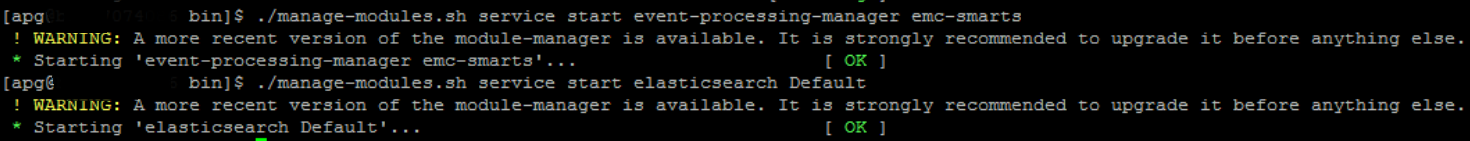

While restarting Watch4net|M&R services it would throw a warning as shown below:

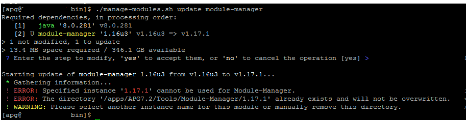

While trying to update the module-manager using the command ./module-manager.sh update module-manager it might throw the below error:
Watch4net|M&R 7.4.1.1
This is because the directory with the latest version is present inside the required directory and would not be overwritten(as the error says):
Follow the below steps to successfully update the module-manager:
1. Take a back up of directory and keep it on a different directory.
2. Once it is backed up remove the 1.17.1 directory from .
3. Execute the below command to update module-manager:
4. Post that try starting the pending services - it should not throw the previous error.
