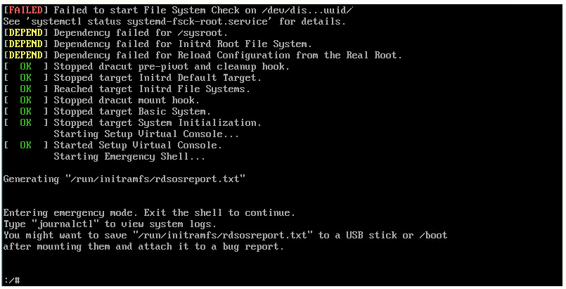

  • During the reboot of the vCenter VM, the sytem drops into an emergency mode with the FSCK (File System Check) phase and it prevents the vCenter from fully booting up.
  • The error message indicates that a manual file system check (fsck) is required on the VMware Photon OS environment.

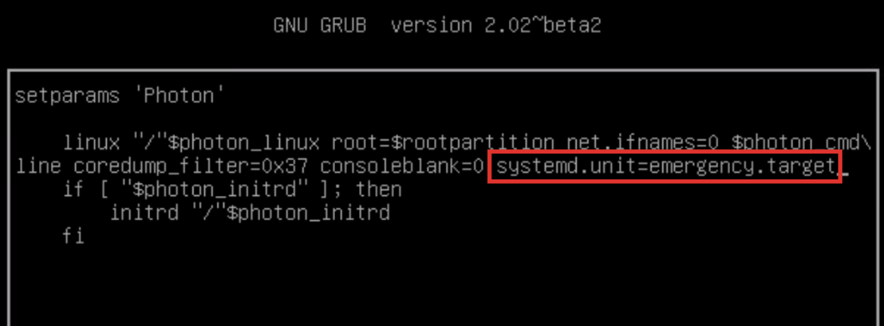

  2. Restart the Virtual Machine running VMware Photon OS. When the splash screen appears, quickly press the letter e to enter the Grand Unified Bootloader (GRUB) edit menu.
    • Note: The letter e must be pressed quickly as the operating system reboots rapidly. To ensure that enough time is provided during the boot to press 'e' key, the Boot Delay setting can be changed to 10000 milliseconds (10 seconds). Refer to this article for more details Delay the Boot Sequence
  3. In the GNU GRUB edit menu, navigate to the end of the line that begins with linux, add a space, and append the following code to initiate specific file system repair : systemd.unit=emergency.target
      Note: To initiate the automatic repair for the affected file systems, add this parameter to the end of the line begins with Linux  "systemd.unit=emergency.target" fsck.repair=yes
