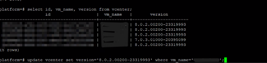

Update the PSQL database on SDDC Manager either manually or use the Async Patch tool-sync option to complete the task:
/usr/pgsql/13/bin/psql -U postgres -h localhost -d platform -c "select id, vm_name, version from vcenter;"
/usr/pgsql/13/bin/psql -U postgres -h localhost -d platform -c "update vcenter set version='<version from VAMI>' where vm_name='vCenter name';
