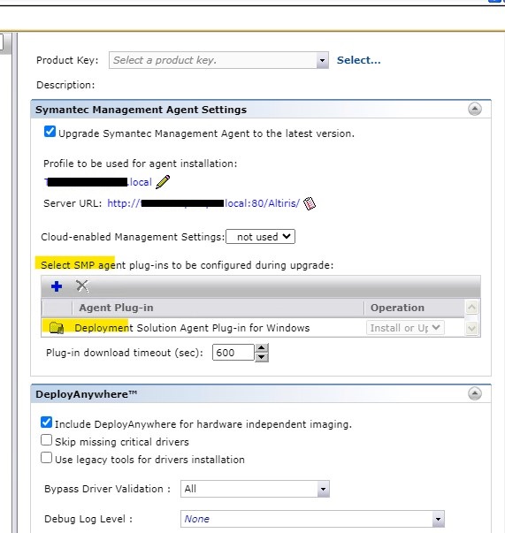

Image contains the old agent and Deployment Solutions plugin which could not report back to the Notification Server
In the deploy of image task, enable the 'Upgrade Symantec Management Agent to latest version' and add 'Deployment Solution Plug-in' under 'Select SMP agent plugins to be configured during upgrade' feature to the task as shown in the following screenshot:
