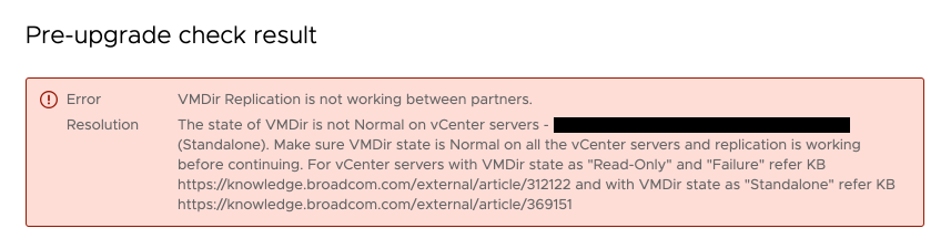

  • vCenter Server update/upgrade pre-check fails during VMDIR replication status check with below error message
    Error VMDir replication is not working between partners.
    The state of VMDir is not Normal on vCenter servers - <VC FQDN> (Standalone). Make sure VMDir state is Normal on all the vCenter servers and replication is working before continuing. For vCenter servers with VMDir state as "Read-Only" and "Failure" refer https://knowledge.broadcom.com/external/article/312122 and with VMDir state as “Standalone” refer KB https://knowledge.broadcom.com/external/article/369151.
