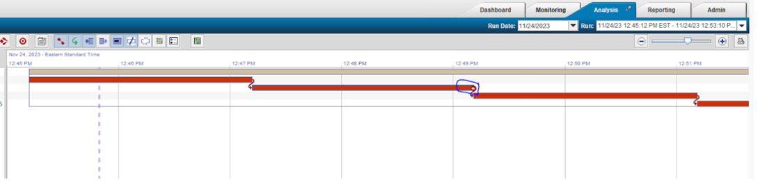

Inconsistency between the thick client and the Web UI v2 with how jobs and their respective status icons were displayed. The jobstream Gantt tooltip now displays Success or Failure for the job run status and the job failure icon is positioned on the right-hand side for better visibility.
With the AAI thick-client, the failed job icon is showing.
With the AAI Web UI, the failed job icon is not showing.
