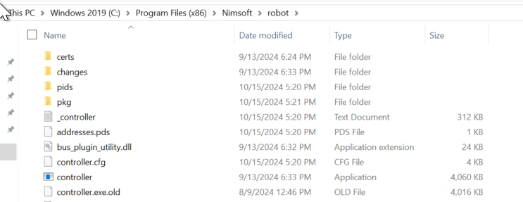

If your Operator Console Robot is already upgrade to Secure and you still experience this issue, this may indicate that the secure robot upgrade was not fully successful.  Although the robot still displays the "S" in the version number, it may be running the old executable.
To verify this, look into the \Nimsoft\robot\ folder and check whether you see "controller.exe.old" in the folder.
If so, take the following steps:
  1. delete the controller.exe.old and any other file in this folder with the .old extension
  2. make note of the "Date modified" timestamp for the remaining "controller"  (controller.exe)
  3. redeploy the robot_update_secure package.
  4. Ensure that the timestamp on the controller.exe updates to the current time.
  5. Another controller.exe.old may appear.  It is safe to delete.
