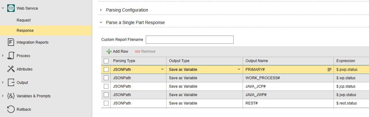

This issue is caused by a misconfiguration in the Response tab of the job object combined with limitations of the older RA REST Agent (v4.6 and earlier). The older agent allowed or required an ampersand (&) prefix in the Output Name field (e.g., &PRIMARY#), which causes parsing conflicts during certain execution cycles like C_PERIOD.
There are two ways to resolve this issue: a manual workaround for existing objects or a permanent upgrade to the supported REST agent.
Method 1: Manual Workaround (No Upgrade Required)
  1. Open the affected JOBS object.
  2. Navigate to the Web Service > Response tab.
  3. Under the Parse a Single Part Response section, locate the Output Name column.
  4. Remove the ampersand (&) from the beginning of all entries (e.g., change &RESULT# to RESULT#).
  5. Save the object. Note: In the newer, updated, IG REST agent, the ampersand is implied and should not be explicitly defined in this field.
