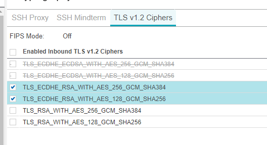

Next, there is a common misconception in that the TLSv1.2 tab appearing under Cryptography in the Security section under the CA PAM Configuration
Does this corresponds to the ciphers supported for RDP client connection?
This is not correct! The above cipher lists correspond only to the ones used for incoming HTTPS connections, i.e. this configuration defines what cipher suites PAM accepts when an HTTPS client connects to it, such as when a PAM user logs on to PAM using a browser or the PAM client.
