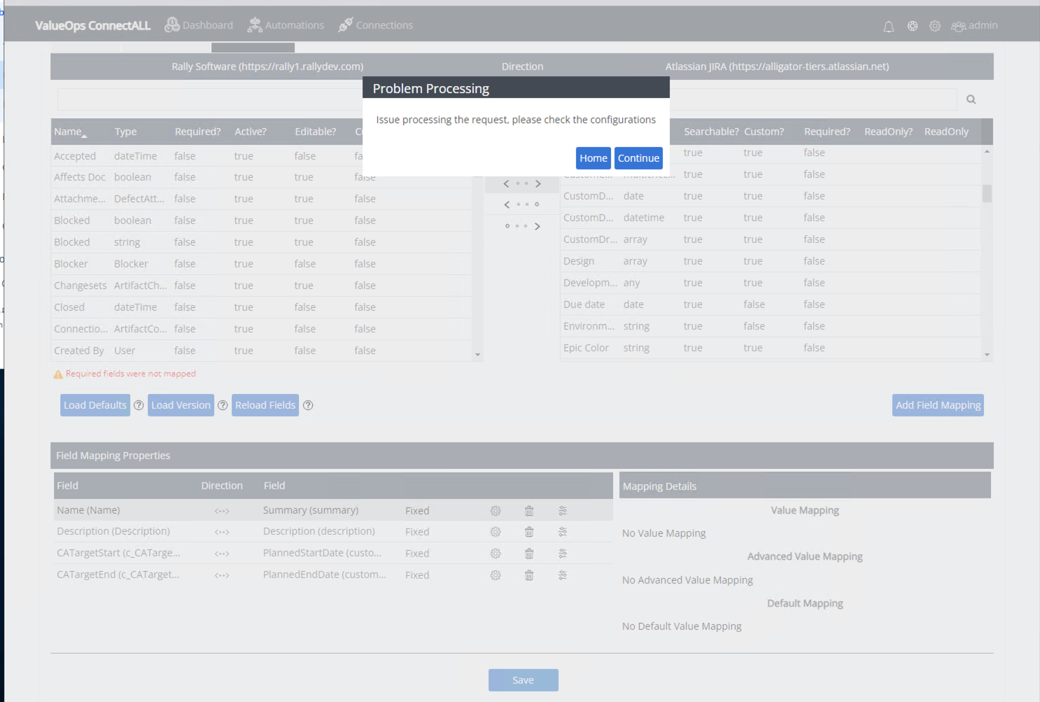

When changing any field mapping for any automation I am getting 'Issue processing the request, please check the configurations' when trying to modify it.  This was seen on version 3.2.
The error was seen on this screen. The screenshot below is from a test environment only.
This issue was caused when a new automation was created and was corrupted directly after being created.  Once the automation was created it was not visible in the list of automations.
JSON files were missing from <CONNECTALL_INSTALLATION DIR>/core/mappings
Ideally each automation should have 3 files - One Connection JSON file and two application JSON files.  In this case only one was present
The resolution for this was to remove the orphaned automation JSON log and recreate the Automation with the issue.
This error was seen in the Server --> c:ConnectALL/Core/Logs/ConnectAll.log file
/Core/mappings/ConnectAllApplication_APPLICATION_TestAutomation_-1487872298.json (No such file or directory)
We found that the application was named Core/mappings/ConnectAllApplication_APPLICATION_TestAutomation2_-1487872298.json instead and had no version files.
We removed the ConnectAllApplication_APPLICATION_TestAutomation2_-1487872298.json file and everything started working.
