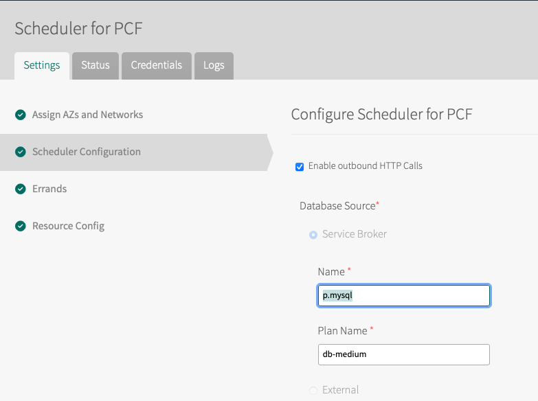

We will first need to identify the plan name of the database source being used by Scheduler. Using Ops Manager, navigate to Scheduler > Scheduler Configuration > Database Source > Plan Name. In this example, we can see that Scheduler is using the “db-medium” Plan Name.
