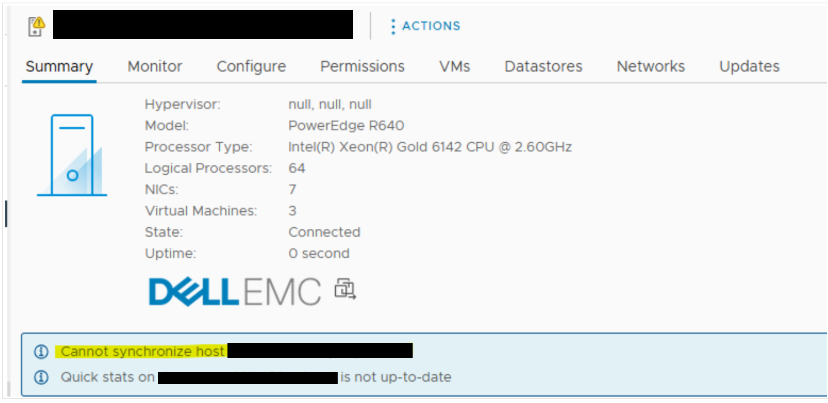

  • Host shows as disconnected within vCenter inventory, despite the host being up and running.
  • The vCenter Server fails to display ESXi host details, specifically storage and network adapter information.
  • Browsing files in the datastore / refresh storage adapter task might fail with the error "An error occurred while communicating with the remote host".
  • Below errors may be observed in the summary page of the host in vCenter:
VMware esx cannot synchronize host "incorrect username and password"
Cannot synchronize host : Cannot complete login due to an incorrect user name or password
Quick stats on "Hostname" is not up-to-date
