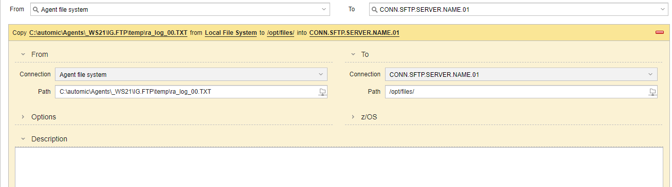

An SFTP job is copying the files into a folder not specified in the "To" settings of the FTP job.
Copying from Local File System to CONN.SFTP.SERVER.NAME.01
copy C:\automic\Agents\_WS21\IG.FTP\ra_log_00.TXT to /path/to/the/wrong/folder/filename.txt
com.automic.agent.ftp.commands.impl.FtpFacadeCommandImpl@55c54fae start: getInputStream(): file: /path/to/the/wrong/folder/filename.txt, skip:-1
Caused by: java.io.FileNotFoundException: /path/to/the/wrong/folder/filename.txt (The system cannot find the path specified)
Instead of:
copy C:\automic\Agents\_WS21\IG.FTP\temp\ra_log_00.TXT to /opt/files/ra_log_00.TXT
