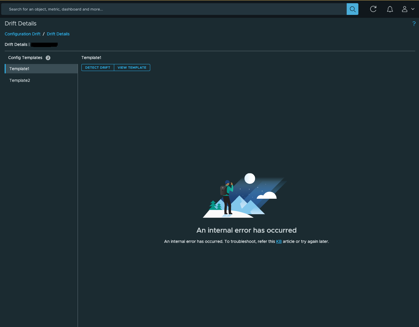

Issue 1: Drift Check Failed with error: "An internal error has occurred".
Possible Causes:
  • vCenter Server is not reachable from Cloud Proxy.
  • Config Module service is not running. (See Appendix on how to check if Config Module is running).
Remediation:

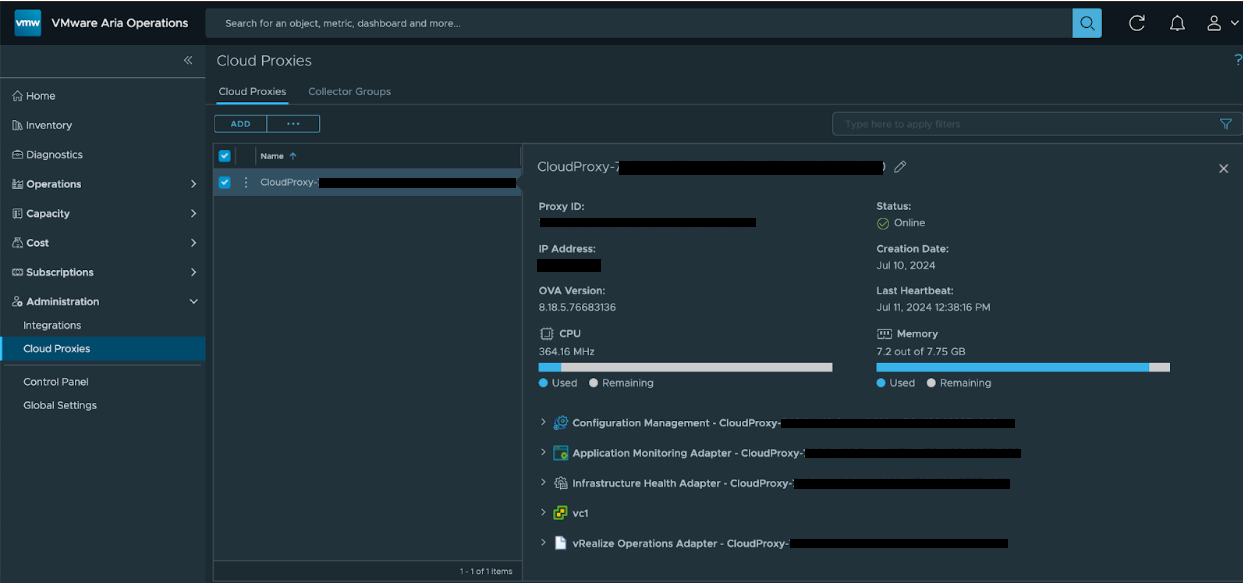

How to check whether the Configuration Management Adapter is Healthy:

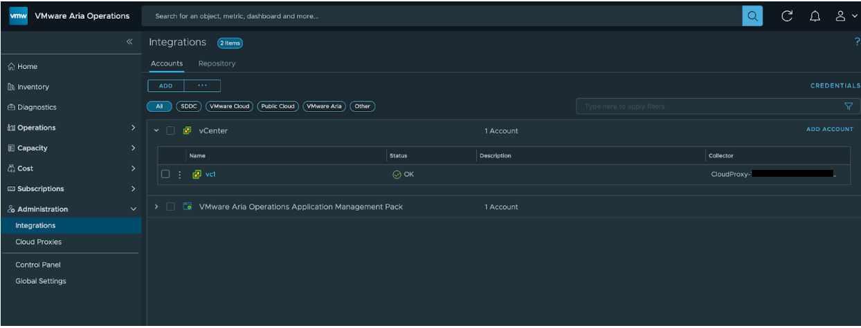

How to check whether VC is reachable and in Collecting state:

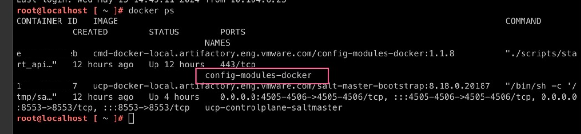

How to check whether the Config Module service is in running mode:
  1. Log into the Aria Operations Cloud Proxy node as root via SSH.
  2. Run the following command to see the status of the Config Module service: docker ps
