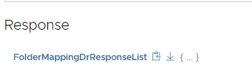

6. Example : We can retrieve the folder mappings using the pairing ID and SRM ID.
