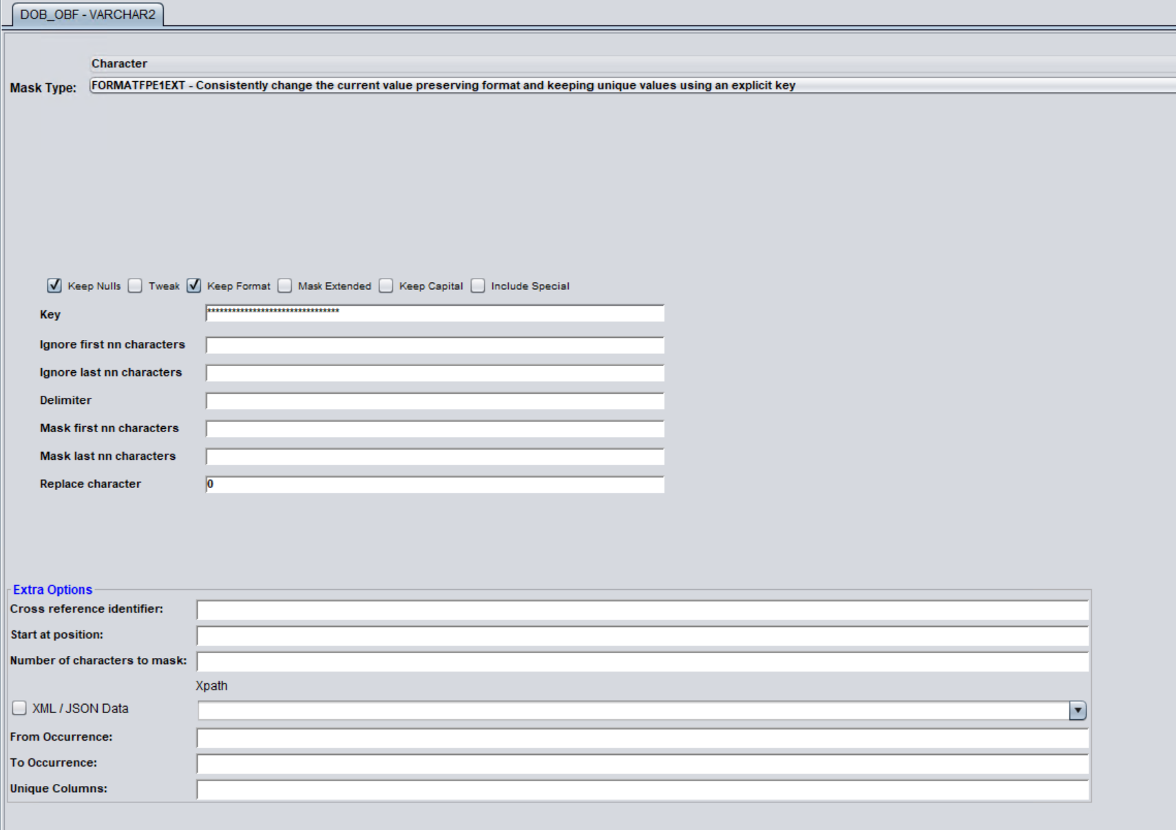

I was able to get the job to run using the FORMATFPE1EXT function, and setting:
  • Keep Format = true
  • Replace character (parm8) = 0
However, the masked results are not valid dates, which is not ideal.
Original DOB_OBF Masked DOB_OBF
1970-02-14 1788-35-02
€%°€%° 0%°0%°
2008-10-31 2495-03-45
1969-12-25 1679-07-07
1976-07-04 1080-99-50
