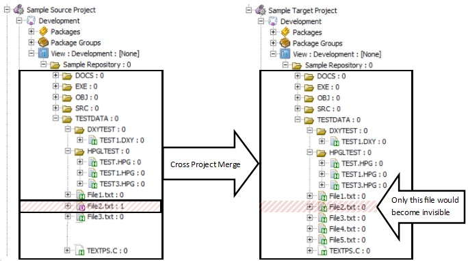

When a Cross Project Merge is performed, selecting a package that contains a "D"-tagged file, the corresponding file in the target project will also receive a "D"-tag:

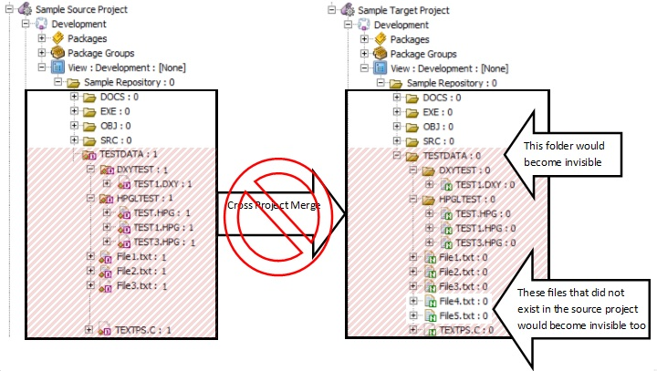

If SCM were to allow a Cross Project Merge selecting a package that contains a "D"-tagged folder, it would mean that the corresponding folder in the target project would also receive a "D"-tag.  If that folder in the target project were to contain any files not found in the source project, those files would also be "D"-tagged and become invisible:
To prevent this possible unintended consequence, SCM will return the error message and the Cross Project Merge will not succeed.

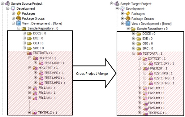

The only exception to the rule is if the same folder in the target project also has a "D"-tag.  In this situation the Cross Project Merge will succeed:
