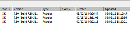

The robot should continue to look for its primary hub. If it doesn’t find it, to help determine what the cause is select the hub in Infrastructure Manager, this is the light green icon with four dots on the outside. You will now see a list of robots in the main window. Look under Type. If the type is ‘Regular’ then the hub thinks this robot has itself as the primary hub. If type is ‘Orphan’ then the hub knows it is secondary to this robot.
When you find an ‘Orphan’ that is not transferring back to its parent you will need to restart the robot. You can do this by right-clicking on it > Restart, in Infrastructure Manager.
