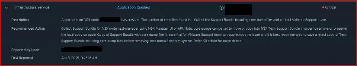

  • Alarms similar to the following in the NSX UI :
    Application on NSX node <node> has crashed. The number of core files found is 1. Collect the Support Bundle including core dump files and contact VMware Support team. Recommended Action Collect Support Bundle for NSX node <nsx manager> using NSX Manager UI or API.

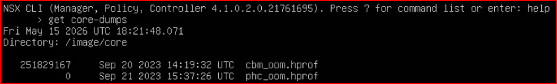

  • The presence of a crash file is verified in CLI as below:
    nsxcli>  get core-dumps
    Directory: /var/log/core
    20762624     May 18 2023 11:44:13 UTC  core.nginx.1559278043.gz
########     May 18 2023 11:44:13 UTC  core.nginx.##########.gz
