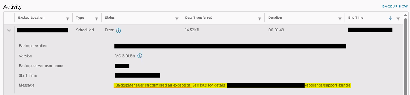

Attempts to perform a file-based backup using the vCenter Server VAMI UI fail. The system logs and interface report the following behaviors:
  1. The error message `BackupManager encountered an exception` appears in the VAMI.
  2. The backup process fails at 5% during the lotus database backup phase.
  3. The /var/log/vmware/applmgmt/backup.log file contains the error: VdcBackupDB: Server in state (8) in which it cannot perform backup. error(9125).

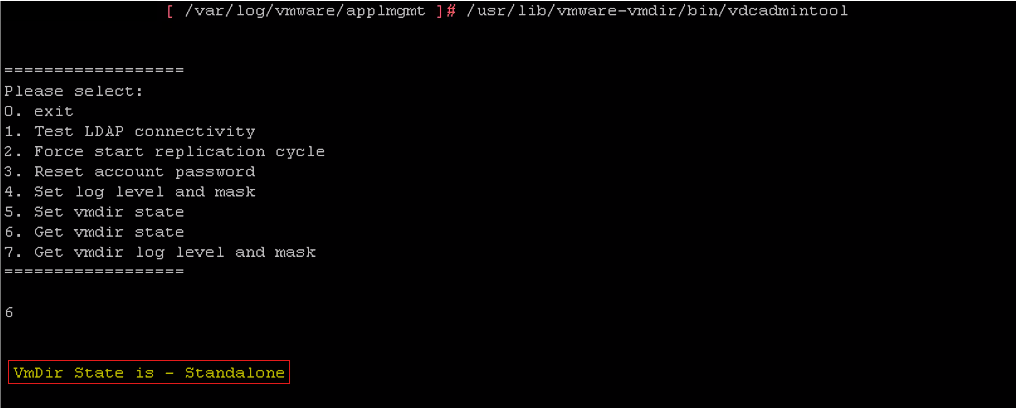

  4. Running the state check command confirms a standalone state:
    • /usr/lib/vmware-vmdir/bin/vdcadmintool
      Select option 6
      VmDir State is - Standalone
