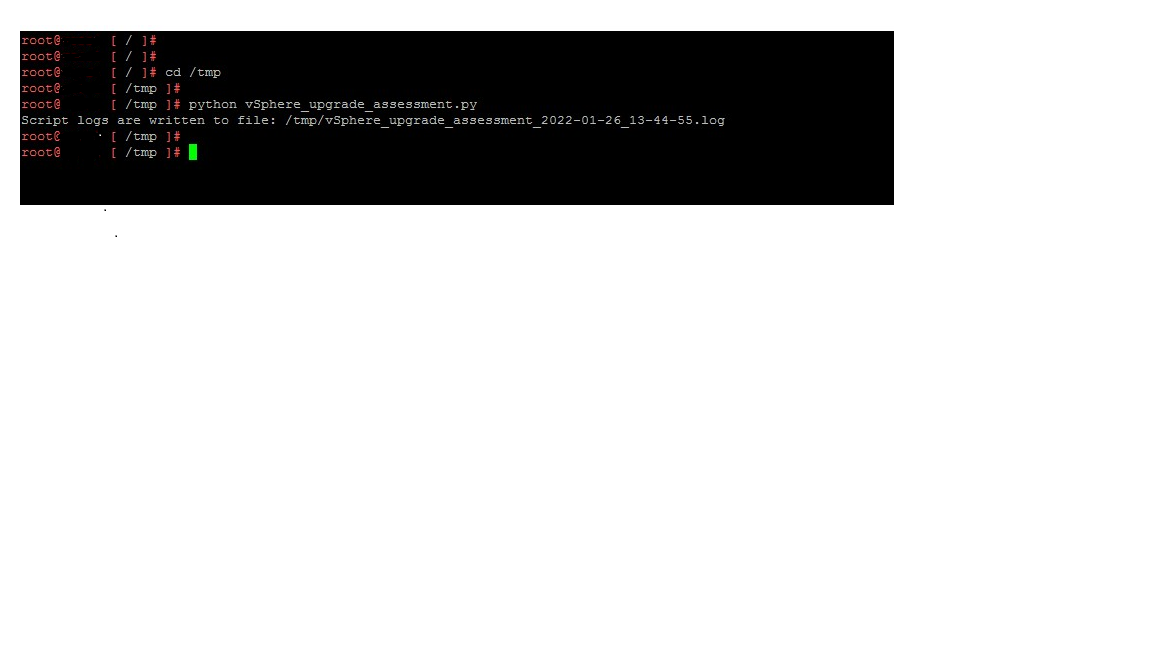

3. Log in to the vCenter Server using root credentials with an SSH Client (using Putty.exe or any similar SSH Client) and change to the directory where the script was placed.
4. Execute the script
python vSphere_upgrade_assessment.py
In this example, the script was placed in the "/tmp" folder
This could take several minutes depending on the size of the environment. A rough estimate is 5 minutes per 100 ESXi hosts, but this will vary depending on resources available to the vCenter Appliance. The log file displayed when the script is started should be reviewed once the script completes to ensure it finished successfully.

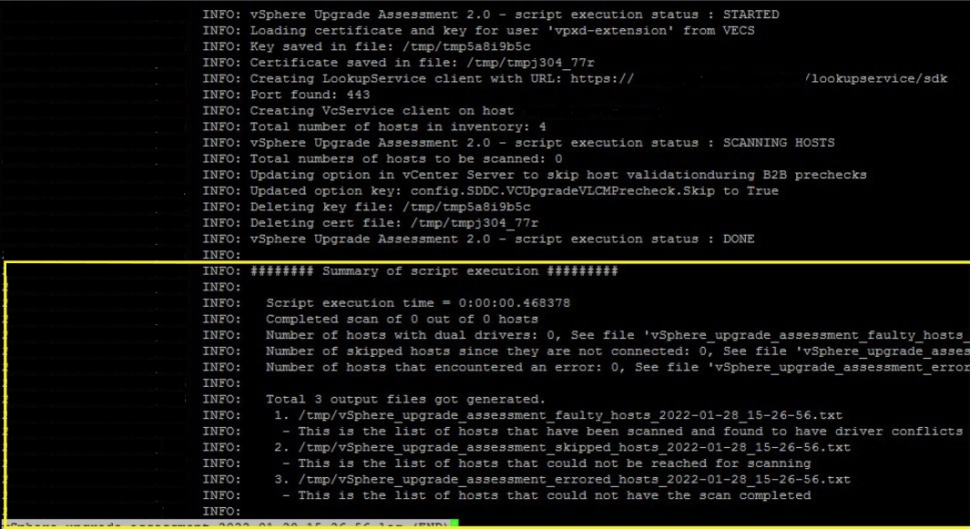

Open the "vSphere_upgrade_assessment_<timestamp>.log" and look for the section highlighted below.
In the example above, the "Completed scan of 0 out of 0 hosts" messages means that no ESXi host matched the initial check and therefore no ESXi was scanned to determine if the "dual driver" issue was present.
The important message is the "Number of hosts with dual drivers:" entry. If this equals "0", then the environment is ready to proceed to the vCenter upgrade and no remediation work is required.
In this 2nd example above, 1 host matched the initial check and had the scan for both drivers executed i.e. "Completed scan of 1 out of 1 hosts"
Reading further, the log file reports that 1 host the "dual driver" issue - "Number of hosts with dual drivers: 1". As there is 1 ESXi host impacted, the "vSphere_upgrade_assessment_faulty_hosts" should be reviewed to find the name of the impacted system(s).
