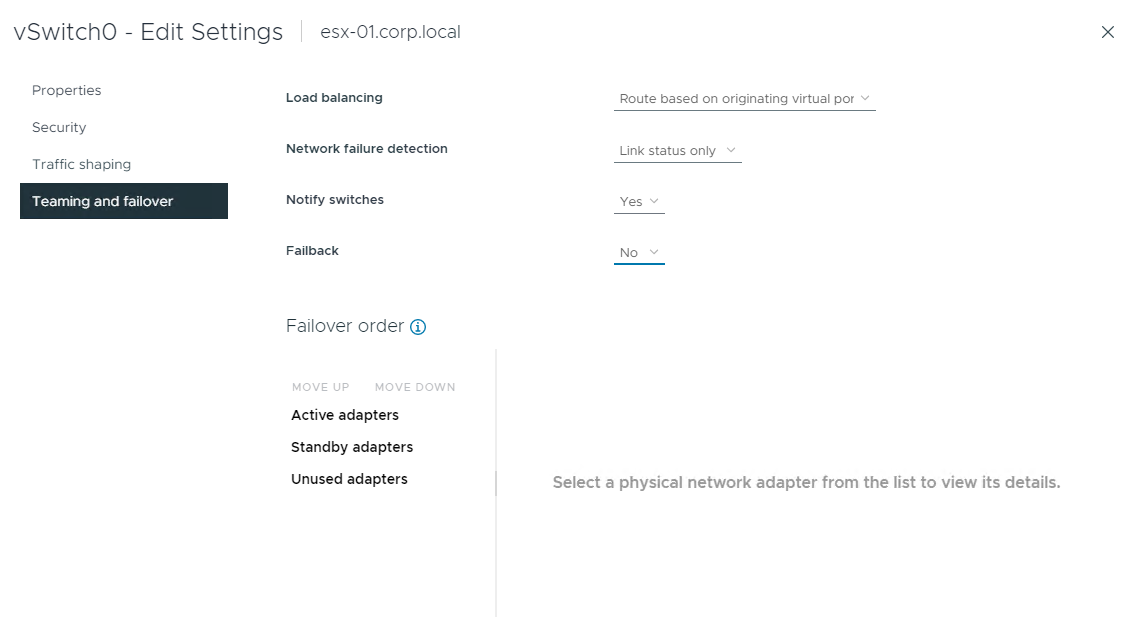

You can prevent the ESXi/ESX host from sending RARP packets upon virtual machine power up, teaming failover, and so forth using the Virtual Infrastructure (VI) Client or vSphere Client. You can control this setting at the virtual switch level or at the port group level.
To prevent RARP packet transmission for a virtual switch:
Note: This setting affects all the port groups using the switch. You can override this setting for individual port groups by configuring RARP packet transmission for a port group.
  1. Log in to the vSphere vCenter Client and select the ESXi/ESX host.
  2. Click Configure tab.
  3. Go to the Networking section and select Virtual Switches.
  4. Click Properties for the vSwitch (Standard Switch). The vSwitch Properties dialog appears.
  5. Click Teaming and Failover tab.
  6. Select No from the Notify Switches dropdown and click Ok.

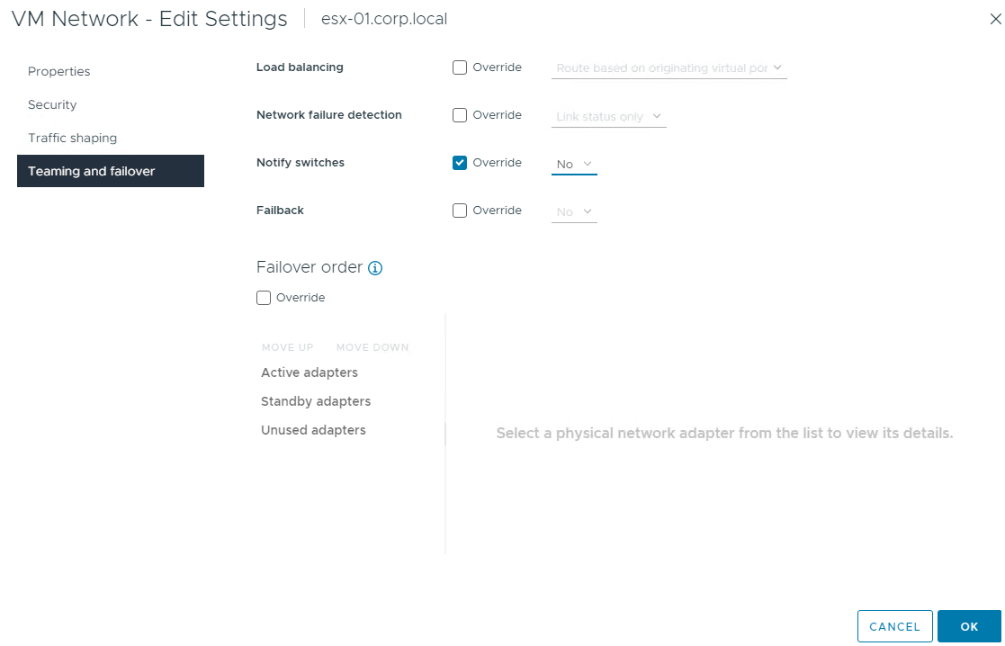

To prevent RARP packet transmission for a port group:
Note: This setting overrides the setting you make for the virtual switch as a whole.
  1. Log in to the vSphere vCenter Client or vSphere ESXi host Client and select the ESXi/ESX host.
  4. Click Properties for the vSwitch (Standard Switch) port group. The port group properties dialog appears.
