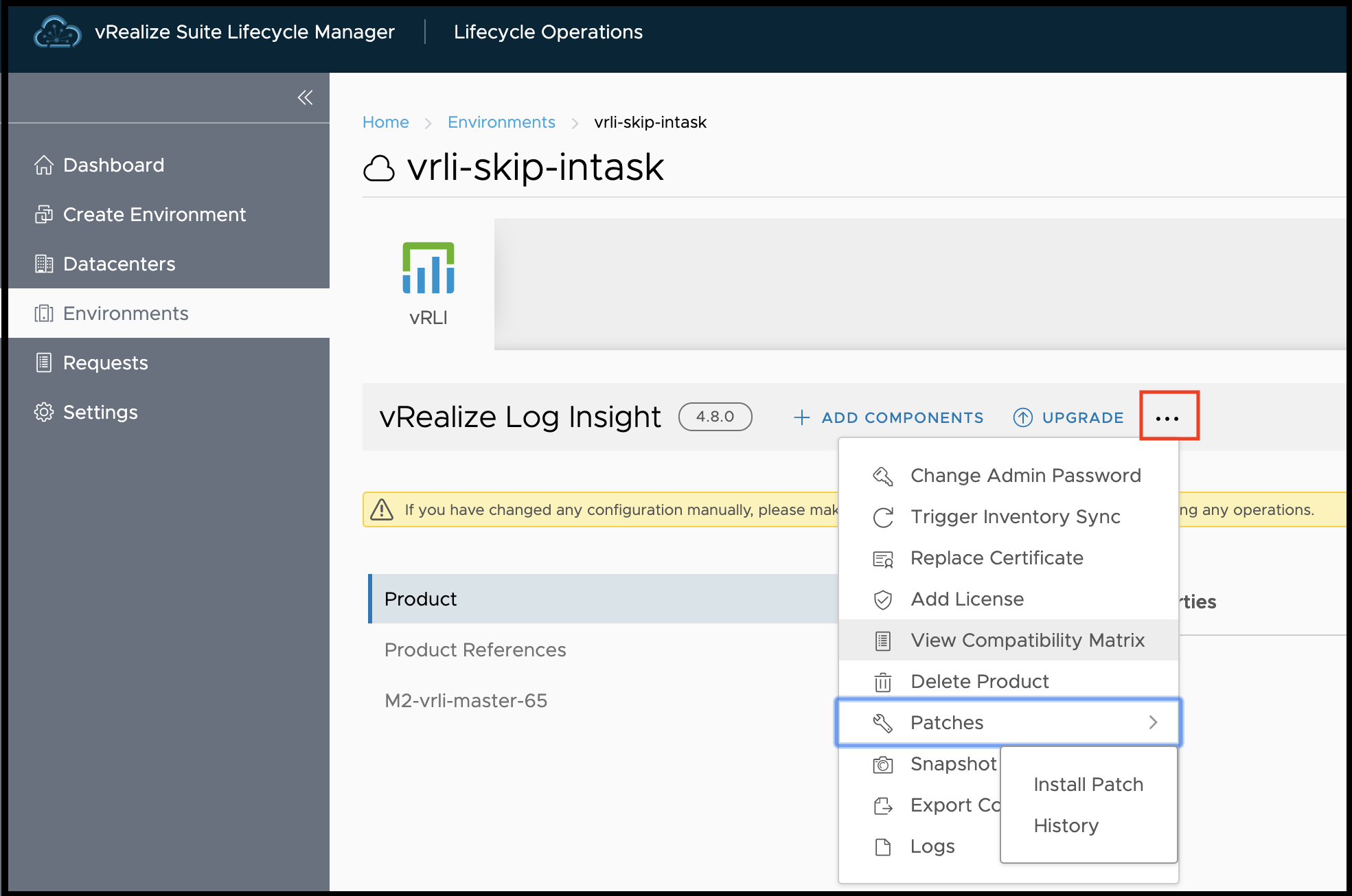

  6. After the deployment of product is successful, go to the respective product cards under Manage Environment and install patches. See image for illustration.
List of patches that contains the relevant change.
  • vRA 7.6.0 HF5
  • vRLI 4.8.0 HF1
  • vROps 7.5.0 HF1
  • vRA 7.5.0 HF13
  1. After the patches are installed, Add Flex licenses to the products from product card.
