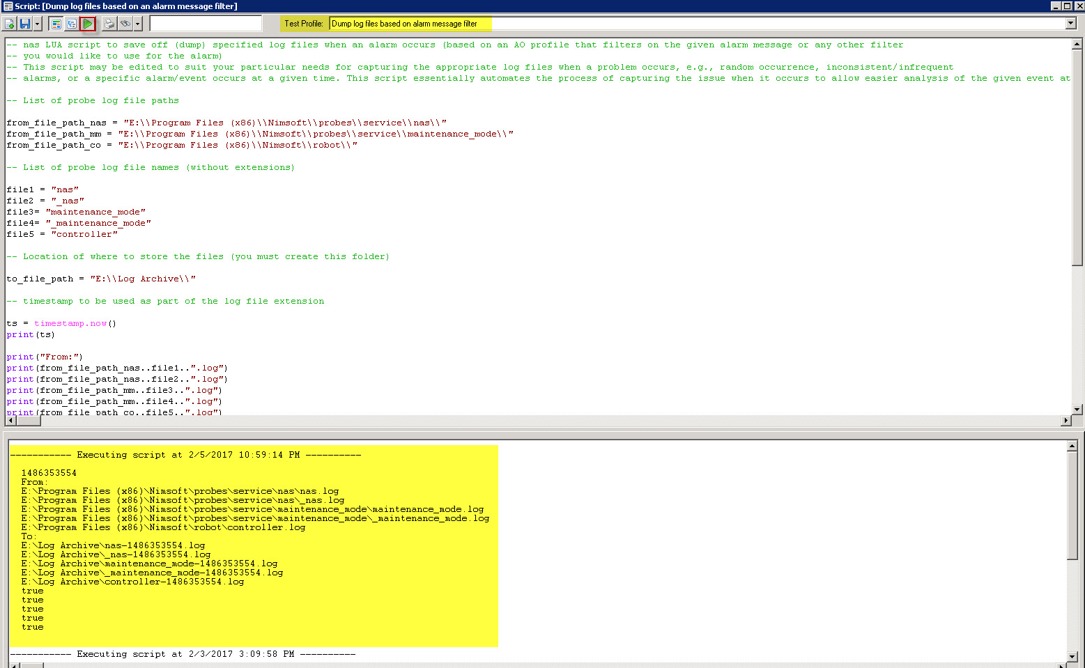

If you run the script from within the nas scripts window you can verify the script run executed successfully. Here is an example of such output:

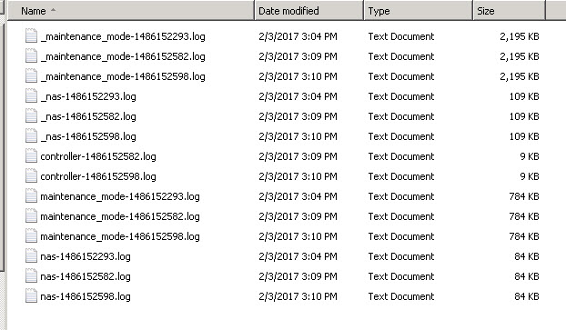

Here is a screenshot of a Log Archive location containing the dumped log files from this LUA script execution:
