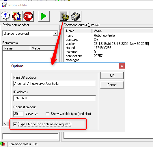

    2. Highlight the 'controller' probe and press 'CTRL + P'
    3. When the probe utility for the controller probe comes up, select 'Options' (the icon with the gear)
    4. Put a check in 'Expert Mode' and click OK

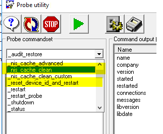

    5. Pulldown on the 'Probe commandset' menu and select '_nis_cache_clean' then press play,
    6. then select '_reset_device_id_and_restart' This will flush the niscache folder, including the robot device id.
      The robot will restart and immediately begin to repopulate the niscache (beginning with the robot device id).

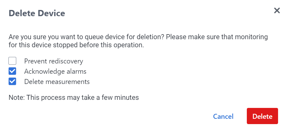

For cloned robots, it might be necessary to Delete the device and have the discovery server to "rediscover it" cleanly. For deleting device:
  1. Go to Operator Console and Inventory,
  2. Find these robots using the search from the Add Filter box.
  3. Put a check in the box next to the robot, from the three dots on the top right pull down select "Delete Selected".
  4.  REMOVE the check from prevent rediscovery and press Delete.
    This will clean up the entries in Operator Console.
