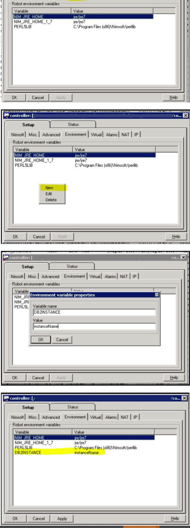

It IS possible to monitor DB2 instances in environments where there is no default DB2 instance. The probe only requires that the DB2INSTANCE and DB2INSTDEF variables be set.
In the robot environment where the db2 probe is installed, set the variable DB2INSTANCE to any existing instance on the monitored DB2 server in the robot environment.
You would configure this through the controller GUI:
The DB2INSTDEF variable is set at the system level by executing the following commands (where your db2 default instance is installed):

Once the DB2INSTDEF variable is set on the db2 system, restart the robot watcher service on the server where the db2 probe is installed.
