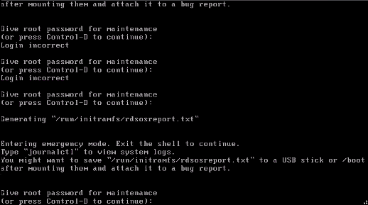

    • Sometimes the VCSA console will refuse to get into emergency mode and will be stuck at the screen below.
    • In this case, enter the line below instead of "systemd.unit=emergency.target"
      fsck.repair=yes
