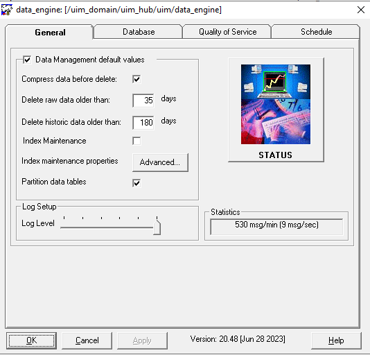

"Delete historic data older than" should be set to a higher number than raw data, and the way it works is that after the number of days set for Raw Data are reached, it rolls it into historic tables. In other words, if you have Raw Data set to 30 days, and Historic Data set to 60 days, then from day 1-30 you will have Raw Data and on the 31st day, the oldest raw data gets put into day one of historic data.
This article assumes that you have the option "Compress data before delete" enabled, which is the default setting.  With this option set, data_engine retention is broken down into three categories: raw, hourly and daily.  Infrastructure Manager is only capable of changing raw and hourly settings.  Admin Console or Raw Configure must be utilized if you want to update the daily retention settings.
When partitioning is enabled in the data_engine, compression ('Compress data before delete'), does not occur, since there is no need to compress the table indexes before the partition is dropped.
  • DX UIM (any version)
Data Engine UI for reference:
