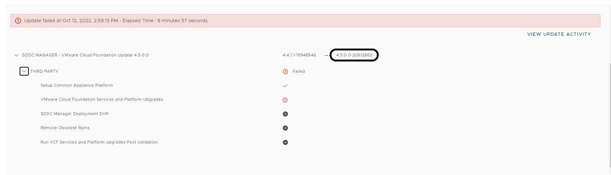

SDDC Manager update to VCF 4.5.0.0 fails in "VMware Cloud Foundation Service and Platform Upgrades" step. Below error is reported in SDDC Manager UI:
or

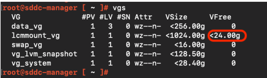

The presence of multiple PVs in a volume group causes this failure. To assert this,
  • Login to SDDC Manager as root user
  • Run "vgs" command to check free space available in the volume group(s)
  • Run "vgs" command to check if there are multiple PVs in a Volume group (AND) run "lsblk" to check if /storage/lvm_snapshot mount point is mounted or not available.
