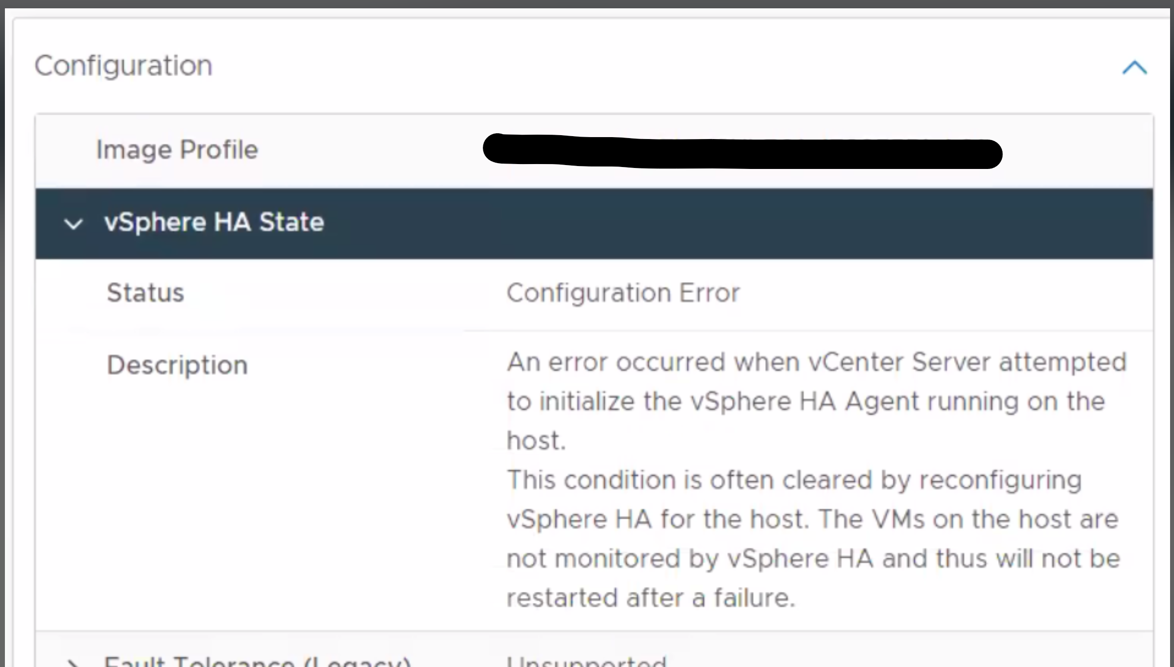

Symptoms:
vSphere HA Host Status error in the host summary
  • Reconfiguring for HA does not resolve the problem.
  • You notice a "configuration error" on the availability status in the host summary tab; when expanded, the following error appears:
"An error occurred when vCenter Server attempted to initialize the vSphere HA Agent running on the host. This condition is often cleared by reconfiguring vSphere HA for the host. The VMs on the host are not monitored by vSphere HA and thus will not be restarted after a failure."
