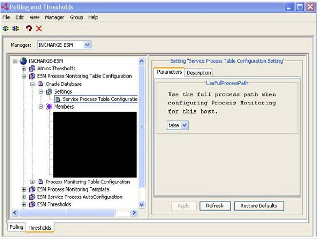

Smarts Server Manager (ESM) Configure Process Monitoring dialog shows large number of Oracle Processes associated with the oracle Process.  The following example of this issue shows that 236 Oracle processes are "lumped" together under the heading of oracle in this dialog:
VMware Smart Assurance - SMARTS
This issue occurs because of a configuration issue. For the Oracle process configuration to use the full application command path, this functionality needs to be enabled in the Polling and Threshold Settings for the Settings Group for the Oracle Processes.
To address the above issue where the processes that are in the Smarts Polling and Thresholds group are associated with only one Smarts Server Manager process, you must enable the process configuration using full application command path functionality. To do this, set the UseFullProcessPath to Enabled with the following instructions or see the guide attached to this article for complete instructions.
To enable or disable full application command path process configuration for a settings group:
1. In Polling and Threshold > Threshold, expand the ESM Domain Manager > ESM Process Monitoring Table Configuration > New Group > Settings.
2. Under Settings, click Service Process Table Configuration settings in the left pane. In the right pane, click Parameters.
3. In the field UseFullProcessPath, select any one of the following values from the drop-down list as shown in the screenshot below:
  True   To enable process configuration using full application command path for the setting group.
  False   To disable process configuration using full application command path for the setting group.
