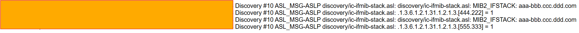

  • When turned on debug and rediscover the device, we can see that the ic-ifmib-stack.asl was being called and returned valid data:
