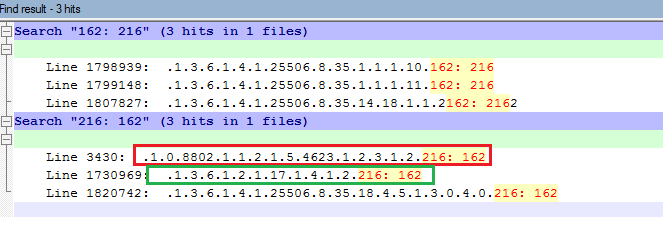

Searching the ns02 MIB in Notepad++ for a possible mapping from port 162 to port 216 (162: 216), or from port 216 to port 162 (216: 162) produces the following results in Fig. 11:
Fig. 11
The top section of the search is not very useful, even though it looks like those OIDs map something with an index of 162 to another value of 216.  This is because the OIDs 1.3.6.1.4.1.25506.8.35.1.1.1.# are H3C oids, but and are not part of the LLDP.
 The values in the bottom section in the red and green boxes on the other hand can be looked up in an OID viewer.  The value in the red box is promising because it is easy to see from the 8802 value in the OID that it is part of the LLDP MIB.  The OID in the green box though is not part of the LLDP MIB, it is in fact part of the BRIDGE MIB.  The definitions of the two oids are as follows:
  • .1.0.8802.1.1.2.1.5.4623.1.2.3.1.2 = lldpXdot3LocLinkAggPortId: This object contains the IEEE 802.3 aggregated port identifier, aAggPortID (IEEE 802.3-2002, 30.7.2.1.1), derived from the ifNumber of the ifIndex for the port component in link aggregation.  If the port is not in link aggregation state and/or it does not support link aggregation, this value should be set to zero.
  • 1.3.6.1.2.1.17.1.4.1.2 = dot1dBasePortIfIndex: The value of the instance of the ifIndex object, defined in MIB-II, for the interface corresponding to this port
Both of these values show an apparent mapping from the logical Port number in the LLDP to the physical port.   But given that the first value is from the LLDP-MIB it is the value that will be used for the mapping.
This evidence shows that there is a mapping in the MIB from the LLDP port of 216 to the physical port of 162 and that the Smarts software is incorrectly associating the information from physical port 216 to the trunk cable connected to physical port 162.  This should be all the evidence needed to demonstrate a connection is not being represented correctly by the Smarts software.
