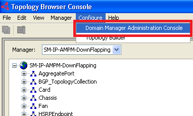

Log into the Smarts IP domain and navigate to the Domain Manager Administration Console (DMAC) from the Topology Browser console:

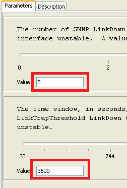

In the right hand window we can see that there are two settings:
LinkTrapThreshold- This is the number of linkDown traps that have to be received before Smarts will alert that there is a problem with the interface. This is set to 3 by default.
LinkTrapWindow - This is the number of minutes in which the trap must come in as a set to cause an alert. The default is 300 seconds.
With the above settings, three linkDown traps would have to come in within a 5-minute window of the first trap for an alert to be generated. How long the alert lasts is based on when the last linkDown trap comes in and the LinkTrapWindow. If only three linkDown traps come in, and generate a DownOrFlapping event and the link trap window is set to 300 seconds, then the alert will from smarts will clear 5 minutes after the third trap came in. If the link trap window is set to 3600 seconds (max allowed length) then the alert will clear after the last link down trap comes in.
The alert timer gets reset to the LinkTrapWindow time ever time a new trap comes in while the alert is still active.
Set the LinkTrapThreshold to 5 and the LinkTrapWindow to 3600, click Apply then Reconfigure as in step 6:
