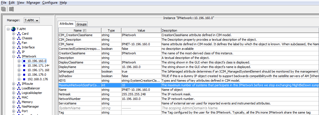

A device failing to be correlated to a Down state by the Smarts IP Manager can be caused by the DefaultMaximumNetworkSizeForCorrelation setting of the Smarts IP domain being too large. This value is used by Smarts to propagate the MightBeDown symptoms between peer systems in a network, the larger the DefaultMaximumNetworkSizeForCorrelation the more MightBeDown symptoms needs to be exchanged for a Down alert.
In a smaller network topology the larger the DefaultMaximumNetworkSizeForCorrelation number the more devices needed to determine a device is down in the IP network. When a device goes down the MightBeDown of the down device is computed based on the neighbor devices and their IP network relation to the device that is down.
DefaultMaximumNetworkSizeForCorrelation is an parameter found in the IPNetwork Class. This parameter is used to prevent propagation of MightBeDown symptom between peer relay devices that are connected through the IPNetwork. These devices are not connected through a network connection or a cable or are not part of the same partition. As shown in the below screenshot
The above (DefaultMaximumNetworkSizeForCorrelation) can also be found in tpmgr-param.conf located at <IP_BASE>/conf/discovery/tpmgr-param.conf.
The default value of DefaultMaximumNetworkSizeForCorrelation is set to 10. However this value can be changed based on the Network Size.
