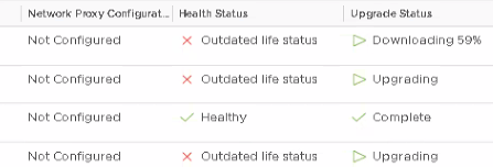

  • After upgrading the Cloud Proxy, its status shows as Offline in the Product UI.
  • Cloud Proxy VMs are stuck on Upgrading status in the Aria Operations Admin UI, even though the upgrade is completed.
