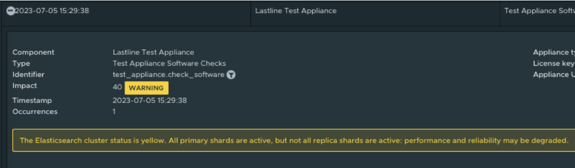

1. The automatic Lastline Test Appliance component check reports an error condition with the message "Unable to get Elasticsearch cluster status" in the Data Node appliance Monitoring Logs.
For the other scenario of "DanglingIndicesState", the elastisearch status reported yellow and you would see in output of  lastline_test_appliance
output: > SOFTWARE:
output: >  WARNING: The Elasticsearch cluster status is yellow. All primary shards are active, but not all replica shards are active: performance and reliability may be degraded.
This is observed in the monitoring log as well.
