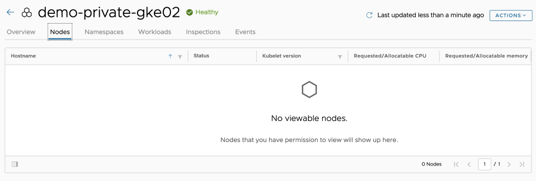

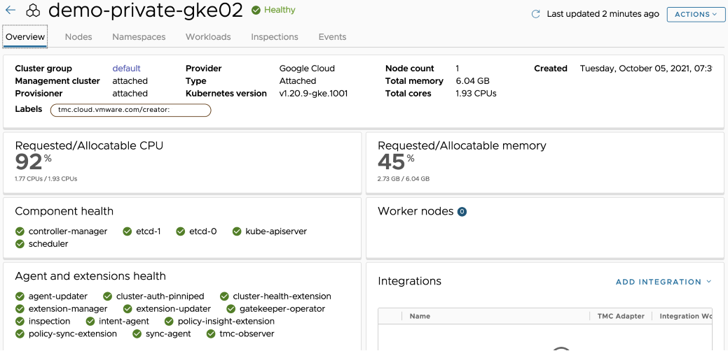

Cluster is showing healthy status on TMC and also all agents showing UP status but nothing is showing under Node, Namespace and workload tab.
The APIService on the cluster is failing discovery check because it's not able to connect to the backend service cluster-auth-pinniped-api. This is because the pods expose port 8443, and on a private GKE cluster the default firewall rules allow apiserver to only have access to ports 10250 and 443 on the worker nodes.
