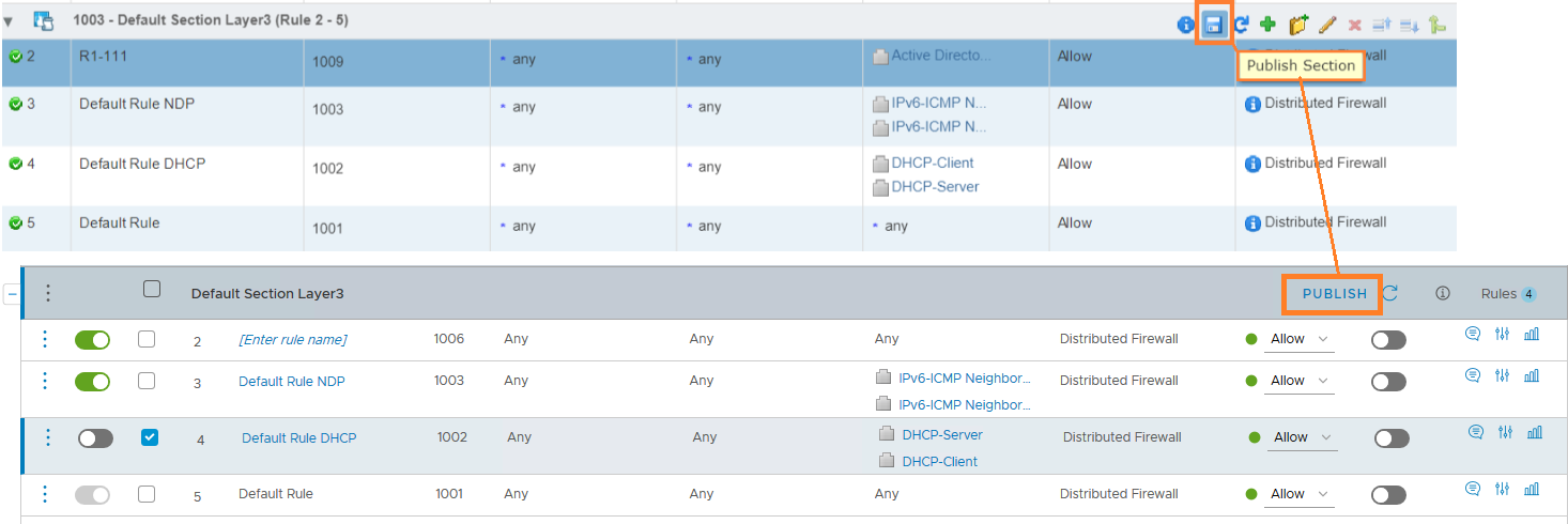

When publishing (globally) a Distributed Firewall configuration after a section has been modified, some rules not belonging to the modified section may be incorrectly matched. For example, when modifying section with id 1003, rules from section with id 11003 are also matched). This may cause the publish operation to fail.
There is currently no resolution.
Workaround:
Two workarounds are possible:
  •  Publish the modified section, instead of the global configuration.
  • Use the filter option to include only the modified rule(s) or section(s), and use the global publish. In comparison to the initial status, the incorrectly matched section is excluded from the publish operation, and will not block it.
