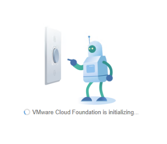

  • The user interface may fails to load and remains indefinitely stuck on the splash screen message: VMware Cloud Foundation is initializing...

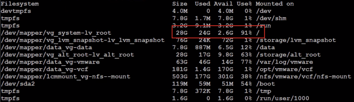

  • Root partition on SDDC is full or almost full.
  • Checking directories for large with command df -h or du -sh /var/log/* | sort -nr, results in below output.
