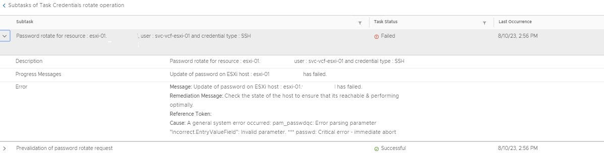

You see a similar error in the operationsmanager.log
/var/log/vmware/vcf/operationsmanager/operationsmanager.log
YYYY-MM-DDTHH:MM:SS ERROR [vcf_om,5cec44d36dae81fd,f46c] [c.v.v.p.u.c.AbstractPasswordChanger,om-exec-4] A general system error
 occurred: pam_passwdqc: Error parsing parameter "Incorrect.EntryValueField": Invalid parameter. *** passwd: Critical error - immediate abort
com.vmware.vcf.passwordmanager.exception.PasswordUpdateException: A general system error occurred: pam_passwdqc: Error parsing parameter

Caused by: com.vmware.vim.binding.vmodl.fault.SystemError: A general system error occurred: pam_passwdqc: Error parsing parameter "Incorrect.EntryValueField": Invalid parameter. *** passwd: Critical error - immediate abort
