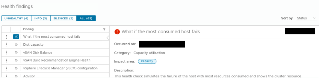

  • vSphere reports the following error for the vSAN cluster - "What if the most consumed host fails":
  • On vSAN Skyline Health the following error is seen - "What if the most consumed host fails":
