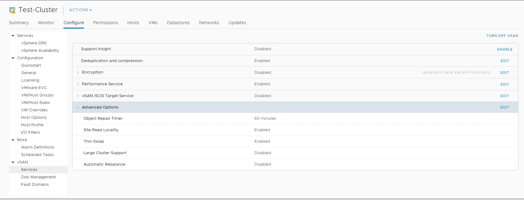

Steps for 6.7U3 and higher but below version 7.0U3d:
