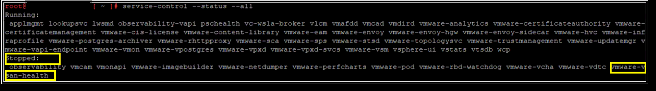

The issue can occurs if vmware-vsan-health service is not running, or was started prior to healthy SPS service.

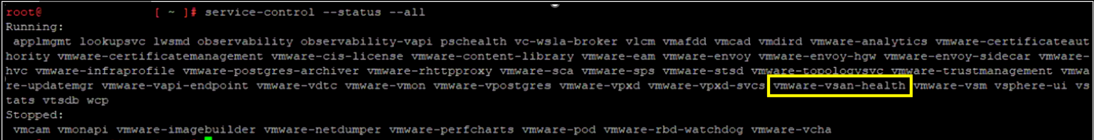

  • Ensure that the vmware-vsan-health service is up and running.
  • If vmware-vsan-health service is stopped, start it by the command "service-control --start vmware-vsan-health"
    • If vmware-vsan-health fails to start, please contact Broadcom Technical support and open a support request referencing this KB.
If vSAN health is running and not done so already. Attempt to reboot vCenter if possible, as this will ensure everything boots in proper order and flush out any lingering stale data (from memory or cached).
