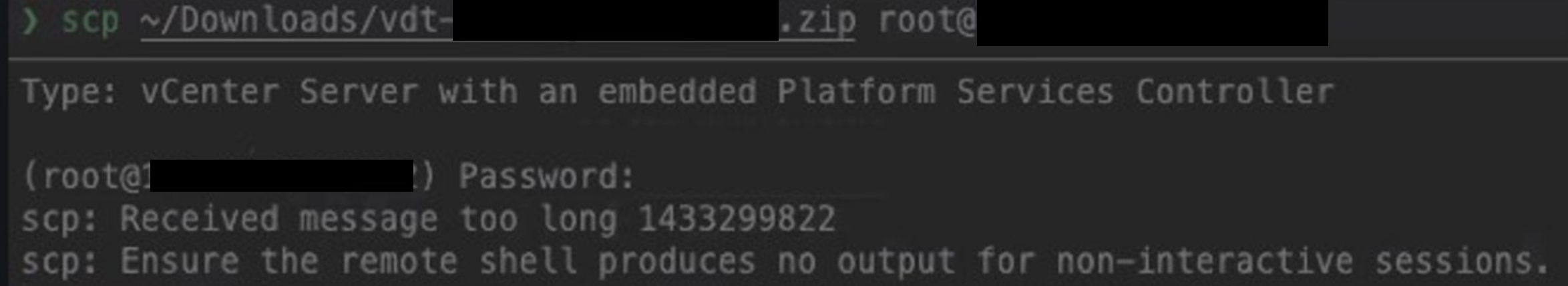

  • Connecting to vCenter Server using WinSCP fails with the error: "Received too large (1433299822 B) SFTP packet. Max supported packet size is 1024000 B"
  • Attempting to upload a file to the vCenter Server using the SCP protocol via WinSCP, PSCP or other SCP clients fail with the error: "Host is not communicating for more than 15 seconds. If the problem repeats, try turning off 'Optimize connection buffer size'"
  • When using WinSCP, part of the operation occurs on the target system. The default Appliance Shell cannot be the remote partner of WinSCP.
  • By default, VCSA is set to Appliance Shell, but SCP requires Bash shell.
