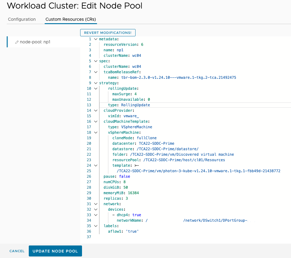

    2. Manually modify the TCAnodepool CR to update the TKG upgrade strategy as illustrated below:
      In this example the workload cluster is wc04 and the node pool is np1:
strategy:
    rollingUpdate:
      maxSurge: 4
      maxUnavailable: 0
    type: RollingUpdate
